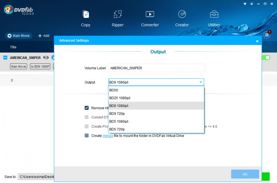

          You can put HD audio on DVD in Blu-Ray format you'd just have to play the disc in a BR player.
            90312:The OP wants to put 7.1 sound from a bluray to a dvd in a bluray to dvd conversion.Are you saying this can be done as the OP wants this using Fabs blu ray to dvd convertor?
              I'm saying if the object is putting the BR on a DVD just select it from the drop down menu. It will be copied in BR format on a DVD and HD audio can be copied. The DVD will be a BR disc and must be played in a BR player. Oh and you'll want to uncheck the "remove HD audio" box.
