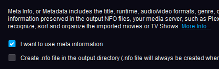

      Could this settings be the cause of the problem:
      1 - Is DVDFab uploading anything?
      2 - How "much" data is usually downloaded?
      3 - What happens when no meta-data is found?

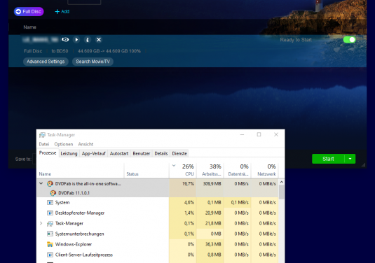

                          For me the problem still occurs with each new version, including latest v11.1.0.5:
                          1 - Just insert a disc and wait for DVDFab to have finished(!) the initial reading
                          2 - Do NOT start the copy process yet ...
                          3 - Open the Task-Manager and check which process creates the most CPU-load
                          Regards!

                              Hello Mona,
                              the problem occurred with each and every disc I tried!
                              (at least 7-8, both recent and older titles)
                              Thus I strongly doubt, that the disc has any relation to the problem,
                              much more likely it has something to do with the machine/setup .... either yours or mine.
                              So maybe someone else can check:
                              1 - Insert a BluRay and wait for DVDFab to finish(!) the initial reading
                              2 - Do NOT start the copy process yet!!!
                              3 - Check the Task-Manager for the process creating the highest CPU-load
