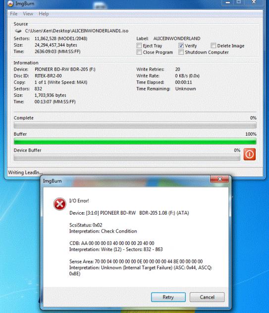

    I have been using DVDFab to rip the backup to the hard drive as a img file using full disc. I then compress the .img file to a smaller .img file that will fit on a single layer Blu-Ray and everything seem to work fine until I try to burn the 23GB .img file to the blank disc using ImgBurn as which point I get the error below.

      I have a couple re-writable discs and the funny thing about it is I don't have a problem with using them, but when I try BD-R I get the error message.
        Ok then what kind of burner do you have and what kind of media are you using? Also I would post your imgburn logs here.
        SPECS
        DESKTOP: Asus M4A79XTD EVO/AMD Phenom II x4 945/4GB GSKILL DDR3-1600/NVIDIA GeForce GTX 260 Core 216 SC/BFG Tech 600Watt/NZXT M59/LG BD-RE GGW-H20L/Lite-On iHAS124 Y/WD Velociraptor 150GB/Seagate 1.5TB/WD Caviar Green 2TB/Acer H213H 1080p
        SERVER: MSI K9ND Speedster WA-6/2x AMD Opteron 2218s/8GB Kingston DDR2-667/NVIDIA Quadro FX 1700/Zalman 600Watt/Alienware Workstation/Lite-On iHAS120/Seagate 500GB/WD Caviar Black 750GB/Swiftech H20-220 w/ 2x CPU blocks & VGA block
          It is a pioneer BDR 205 with the latest firmware and I have tried using memorex, ritek and Verbatium without luck on any. Things just started not working today, wasn't having any problem before, wondering if it might be problems with the pioneer drive?

            W 20:31:24 Failed to Write Sectors 832 - 863 - Reason: Unknown (Internal Target Failure) (ASC: 0x44, ASCQ: 0x8E)

            E 20:34:50 Failed to Write Sectors 832 - 863 - Reason: Unknown (Internal Target Failure) (ASC: 0x44, ASCQ: 0x8E)
            E 20:34:50 Next Writable Address: 0

              try plugging your burner into a different connector for your power supply. i had the same issue. ended up plugging it into a different rail on my power supply and it all wet back to normal.
                This might seem like an obvious questions --> "things just started not working today, wasn't having any problem before"
                Has anything else changes on your system in the last day or so ? New software/hardware etc... ?
                It might be a bit obscure, however I've had things like this that have contributed.

                  Yeah I would try all the things they suggested, or it could be your burner is dying.

                    Have tried using a different power connector and still having the same problem. No I haven't changer anything in either the software or hardware.
                      I have the same Pioneer drive. I started having problems and made 2 coasters before I realized that the eSATA port in my docking station is going bad...
