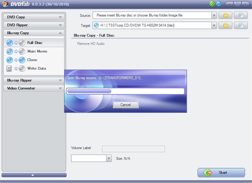

    I thought that it would be as easy as putting it in my burner, load it and then create my own .ISO of them. I was not able to do so with none of the movies.
    What I am doing is:
    1) On the left side I click BLURAY COPY and then FULL DISC.
    2) On the source line I click the folder icon. DVDFab start loading it (with the typical display that says it SCANNING THE SOURCE DISC and it seems to start reading it. After about 8-10 minutes, the display goes away, it goes back to the DVDFab screen, but nothing is loaded... so the start button is not enabled and I can't do anything else.
    3) After this has happened, I close DVDFab, it closes and the main screen goes away, but I noticed that it is still running and it refuses to disappear from the Task Manager. I can't kill it even with the END PROCESS from the Task Manager. I have to reboot the PC.

    Hi, rpareja,
    1. To load ISO image file with DVDFab, you need first a virtual drive to mount the ISO, you can get the free DVDFab Virtual Drive at http://www.dvdfab.com/free.htm.
    DVDFab Virtual Drive is a virtual DVD/Blu-ray emulator. It emulates maximum 18 drives and works with DVD/Blu-ray images created by DVDFab and other programs.
    2. "On the source line I click the folder icon": Please note that if you are going choose the original disc as source, you need click the disc icon right beside the folder icon.
    3. Concerning the speed, ripping process ranges from 45 minutes to 90 minutes, compression process ranges from 2 hours to 3 and a half hours.That all depends on your computer configuration, the size of source blu-ray disc, the write speed you chose, etc.

                  Hi rpareja:
                  Please goes to Common settings dialog -> DVD/Blu-ray -> Pathplayer, and check whether you've enabled the redio button of "Always enable PathPlayer".
                  If no luck, please download Passkey here: http://www.dvdfab.com/passkey.htm
                  And I'll expect your replay.
                  Thanks
                  Potti
                    Hi Potti,
                    I selected "Enable PathPlayer when necessary", and nothing... Then I downloaded the Passkey, installed it, reboot and everything started to work as expected.
