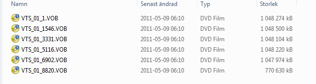

Crazy numbering of VOB files

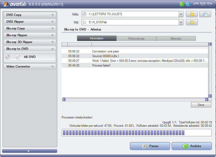

    Start a converting. Let it run so it creates 3-4 vobs. Then cancel the task and use the Back button to get back to the first window where the selection of titles is. Then start a new converting.
    This time it numbers the VOB files in a wrong way and at around 80% it terminates in an error.
    If I do the converting for the first time, no problems. It's only if the task is aborted and restarted with the same source disc in there is an issue. Tried with some random discs and it happens with all.
    Conversion: one pass: 05:06:32
    Source( 00000.m2ts )
    : 05:06:32
    Work 1 failed, Error = 504.00 0 error: process exception, filter(type128:id28), info = 503.00 13,
    : 05:49:27
