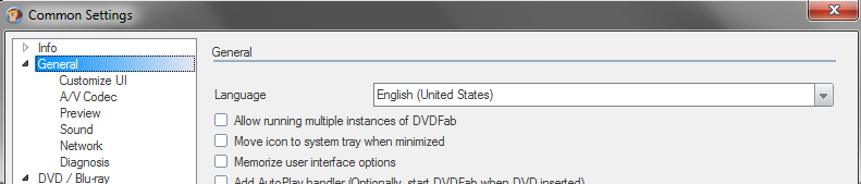

                        Be sure in Fabs settings that English is selected. I noticed on a fresh install even though the program displayed in english it was not selected and after I set it the error went away.

                            Hi freeforever03
                            I know you have stated that the GUI language is English. The setting that W&B is referring to is
                            Open Fab click the Click the Green at top right corner of the DVDFab screen, and open Common Settings > Click General and on the top of the screen you will see Language setting.
                            Also set Pathplayer to Always Enable and restart Fab.
                            Hope this helps
                            CBR929
                              Thanks CBR929. I didn't notice the language setting under the "general" heading. I can't believe that I missed it (it is the first item!!!!!!!). I just changed it to English and will give it another try.
