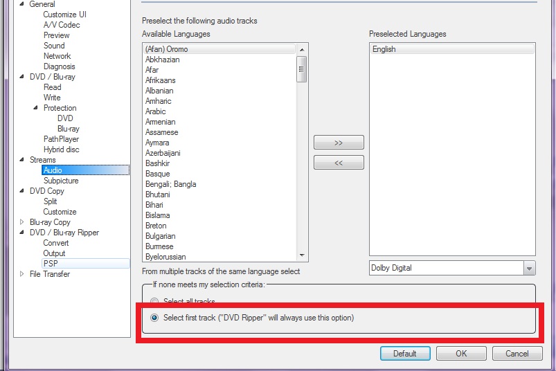

              I'm in the US region 1 so English is always the first (top) selection so I checked the box to always use the fist one and Fab has never selected any other language. See attachment:
                Sweet. I have set mine up just like the attachment. Thanks for the picture. I will see if that works next time.
                  Be sure English is the only selection in audio streams as well, I'm not sure which one is the deal since what I shared with you says it's for the ripper but it seems to work in DVD Copy too.
                    I have the setting set as in the picture and it still defaults to Spanish (Not English) currently using v8.1.0.6bQT though this was an issue in v8.1.0.5QT.
