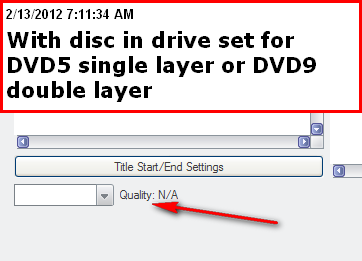

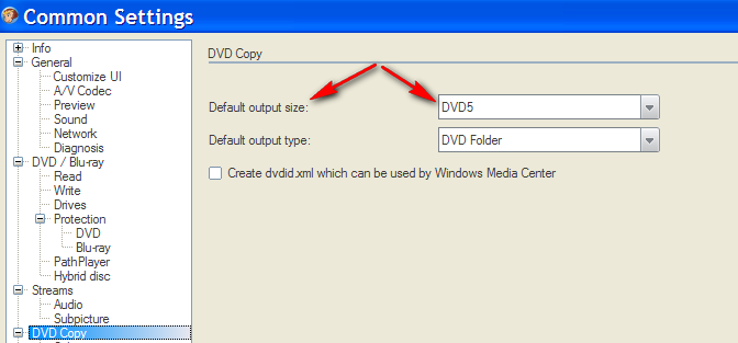

    To my knowledge I thought when you selected DVD5 it would allow you to burn to single layer disks and DVD 9 was for Dual layer/ Blue ray. my DVD fab on DVD5 setting Very Rarely allows me to burn Single layer DVD's now is this Normal or am I missing a setting that will allow this to happen??
    Do you have both options set for DVD5?
      DVD 5 Option
      Yes both of those are clicked when I am Burning DVD's

                  Doesn't matter much what the burn settings are ... the RIP (or copy) settings must be set for DVD5, as that determines what size file you get, and what you can burn it on. (DVD 5 or DVD9 blank)

                      Yes... I'm aware of that, as are most of the other contributors... but many of the OPs are new to this, and may not fully realize what Grunon was really saying...
                      This particular person kept referring to his Fab 'burn' settings, and I just wanted to set him straight on that... any way you cut it, Fab isn't doing the burn... it's either VSO or Imgburn, so the Fab settings are irrelevant.
