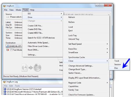

      Imgburn is a little tricky in how you go about finalizing a disc.
        Jeffie, - in what way is it tricky?
          @jeffie hey I don't know much bout computers and img burn real simple find a thread that cbr replied too he has a link on setting up imgburn Havent had one problem burning since I downloaded peace out
          ...Death Before Dishonor...
            I attached a graphic to my post showing how to go about "Closing" a disc and it was not attached. Apparently, new member's post are subject to review which is okay as their information could be dangerous.
            I know that if I was not familiar with Imgburn and went looking to finalize a disc, I might have trouble. As I put it my PM, w/o the graphic, my post looks weird.
            The attachment is now visible - thanks for the support.
                  Jeffie is correct, this is how to do it in ImgBurn
                  Img will finalize as follows:
                  Img > Tools > Drive > Close Track/Session/Disc
