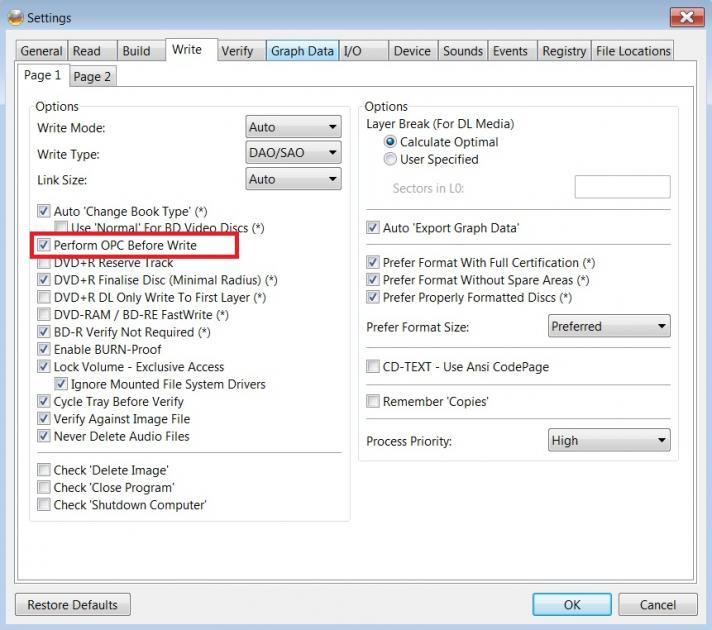

                            Since you have ImgBurn installed, turn on OPC (Optimum Power Calibration) a little mini burn thing Img does to establish laser power required for the media. If that fails it is likely the laser going south, and don't get sidetracked because it still burns CDs that is a completely different laser in the drive that burns CDs.
                            90312; Thanks for the additional support. I will turn on OPC in ImgBurn once I figure out exactly where it is and give it a try. I have read on here that Laptops are not exactly the best for burning/copying DVD's. Do you have a recommendation for a external burner? Again, thank you very much for all your help.

                              Open ImgBurn by the desktop icon and outside of DVDFab. Click tools/settings/write and click in the box, see attached:
