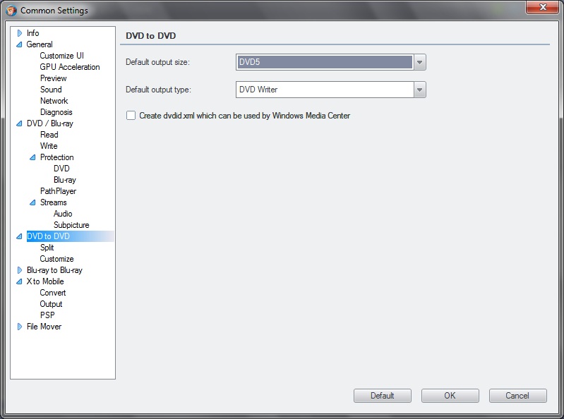

      Can I change the setting to burn to single layer? I started using dvd fab and it only gives me the double layer option?
        Yes in the dropdown beside quality select DVD5 and purchase some 4.7 gb single layer DVD's (I suggest verbs but you can try other brands) The default output can also be changed in Fab's common settings.
