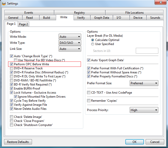

                Open ImgBurn outside Fab and select "Tools" then "Settings" click the "Write" tab and check the box, see attached:
                If your drive supports it a proper laser power level will be set for the media.
