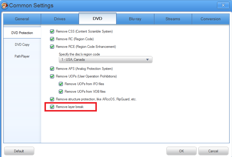

                        Scoop, when burning DL disc I uncheck the remove layer break box and the original layer break is preserved. If it's good enough for the studio release it's good enough for me.
                          Thanks. I did try to uncheck that box on my 4th burn disc but the ImgBurm warning dialog box is displaying this message:
                          "The image it creates will NOT be suitable for burning onto double layer media."
                          When I read that part, I decided to keep that box checked for this burn.
                          Is it ok to ignore the warning messages and uncheck the box?
                          [edit] I goofed. I thought that you were referring to ImgBurn instead of DVDFab, with the ignore layer break option.
