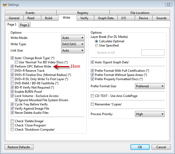

            Remember to set up the AWS in ImgBurn and your burn speed to 1/2 the rated speed of your discs, which in this case would be 2X.
            Also set up the OPC in ImgBurn, to do this open ImgBurn, click tools, write and put a check in the box perform OPC before write, see pic.
