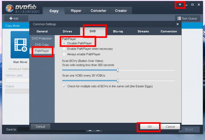

              When making dvd disks and you have trouble you can turn the pathfinder off in Fab settings for dvds and retry making the disk
              When done turn it back on.See screen shot below on how to.

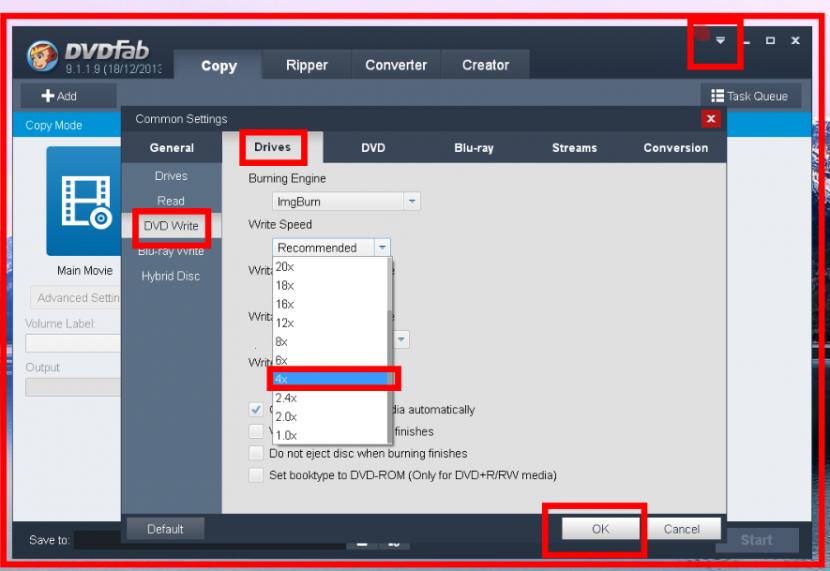

              Second you are using real cheap blank disks ritec (Memorex) and burning at 8 x speed set burn speed to 4x and burn see screen shot.If this doesn't work you just got to try better blank disks if you still have burn problems.
                What ever your problem is this time setting your DVD-5 size to 4488 will give you fits in the future, 4482 is the maximum for a single layer blank. I use customize and set it to 4472 for a small safety margin and so far so good.
