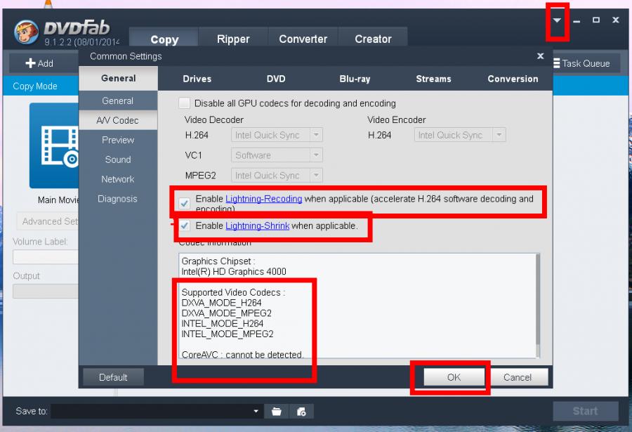

    This depends on what card your using if it has cuda or core avc use it and it will speed things up a lot.Check lightning shrink and lightning recording they will be used when you compress and speed things up lightning shrink works with cuda and quick sync if you don't have one of them leave lightning shrink unchecked.

        What does your computer have in the box in my screen shot?

          It didn't work as quite well for me, but a very helpful moderator, signals, had me do this:
          1) Start ver. 9122, but don't start your copy.
          2) Go to the top right corner and click on the little upside down triangle, from the drop down list select Common Settings
          3) Click on Drives, then Read, then un-check the Enable read-ahead cache box.
          That will help, You can also look above that where it says I/O Mode & change from auto to SPTI.
