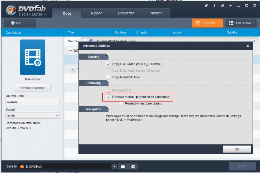

    I made backup copies of three movies using v9.1.5.8 Beta, Main Movie copy mode but, to my surprise, when I played the copied discs they were all Full Movie versions I reverted back to using v9.1.5.7 and that did work and made a copy of the Main Movie as selected. I have never run across this before and was wondering if anyone else has incurred this issue? Thank you.
    Please check "Remove menus..." option in Advanced settings.
      I did as you suggested as the "Remove menus..." option was unchecked in DVDFab v9.1.5.8. I did notice that this box was already checked in v9.1.5.7 so it must be a default feature in that version. Is there a way to keep this box checked in v9.1.5.8 because I found that when I closed DVDFab and opened it again, the box was unchecked. Will I have to do this each time with this version until an updated version comes out? Thank you for your help.
        I can confirm that this is an unwanted change in v.9.1.5.8.
        The advanced setting is cancelled upon exiting and restarting DVDFab.
          It's correct now in V9159. Same as V9157.
