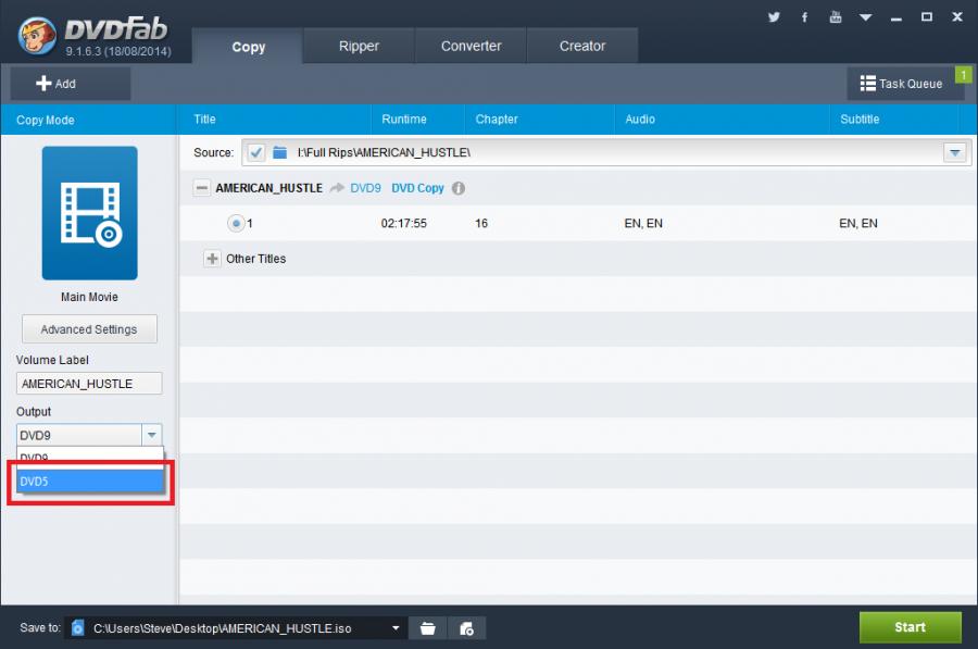

    Without more information from you, internal log, my first guess is when you select iso it defaults to DVD9, mine does, and you need to select DVD5 before you hit GO.
      OK my version does not have the Output option nor the drop down menu to pick from dvd9 or dvd5
        I use the clone option and not the main movie copy option.
        The clone option doesn't have the output drop down menu.
          That's because clone is an exact copy, if the original is on a dual layer disc the output will require a dual layer blank. You can use full disc and compress it to a DVD5 iso if you want.
