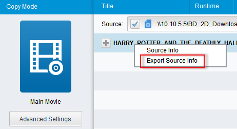

    Seems like that the DVD could not be opened when enable pathplayer, but from the log, you opened the DVD through add the VIDEO_TS folder manually after disable pathplayer, please try to export source info and save to a folder(contains VIDEO_TS folder (IFO files) and DISC.BIN file) if the option could be used. And then please zip them and attach to here;
