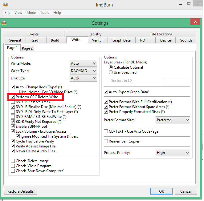

                          Start with 8x, 4x seems unnecessarily slow for the media you're using. ImgBurn with OPC set is by far your best bet.
                            This may seem like a silly question but what is OPC? Also, if I end up trying to set up with ImgBurn, after downloading and installing ImgBurn, do I just follow the numbered steps 1-5 and then 1-8 to finish? I found that when I click on the site listed under "Setting up ImgBurn," the first steps are 1-5 but then 1-15 instead of 1-8. I sometimes use TDK discs as well as Verbatim, does ImgBurn recognize them as well? Thanks.
                              "O"ptimum "P"ower "C"alibration it sets the laser diode's power based on the media used.
