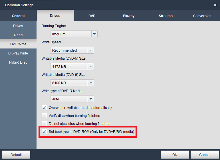

          If the disc plays fine in one player but not another you wouldn't think it's a bad burn. Just to be on the safe side burn at ½ the rated speed of the blank media and set the booktype to DVD-ROM for compatibility with more players. See attached:
            Thank you for the response 90312.
            As u suggested, I changed my write speed from 4 to 2. I don't care that it will take longer as long as the dvd plays. I also checked the second suggestion.
