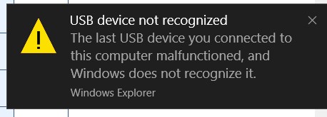

    I have been having this issue for awhile, across several different versions of DVDFab. It doesn't happen all the time, that is the part that has me scratching my head trying to figure if it is software, hardware or maybe combination of the two.

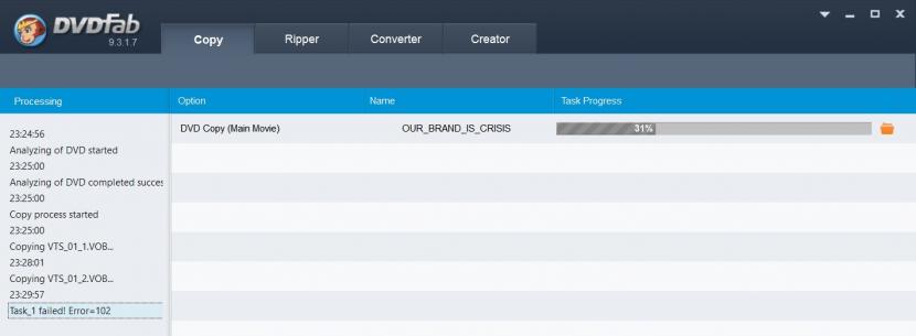

    When I am ripping a DVD, the program will crash and I will get a message that states: USB devise not recognized. The last USB devise you connected to this computer malfunctioned, and Windows does not recognized it. I try to copy the same disc and receive Task_1 failed! Error=102. Sometimes restarting the computer fixes the issue, but other times it does not. Can someone help me resolve the issue? I have been using DVDFab since v3, it only has started to do this in the past 12-16 months, and it is not all the time. I can put in a disc, have an issue and put in a different disc right after it and it will copy just fine. Sometimes I'll put the first disc back in right after the second and again no issues.
    I've attached the two jpg screen shots and the crash file from the rip. The copy I do not get a crash report, I just get the error message.
    I guess it's a hardware problem, since DVDFab writes output data as quick as possible, maybe the usb drive is not working correctly.

      When this happens check to see if windows see's your dvd drive if windows doesn't see the drive Fab can't.Try plugging into another USB plug on the computer and check for loose wire or use different UBS wire from drive to computer as they go bad sometimes the ends of the plug get damaged.
      You can also uninstall the dvd drive from device manger then restart computer and windows will grab new device drivers for the dvd drive and that helps sometimes.

              All of these makes quite a bit of sense. My guess would be the cord, mostly the USB connection from the DVD unit.
              Any suggestions on where to buy a replacement cord. The connection into the unit looks like two boxes, with the top one being a bit smaller and at the bottom of the smaller box is 5 pins. I'm have a brain cramp right now, I cannot think of what this cord is called.
                Try uninstalling the drive first then restart computer this can be a windows thing very common also.Try Best buy look on their internet page to save a trip their if not go to drives manufacturers internet page and order one from them.
