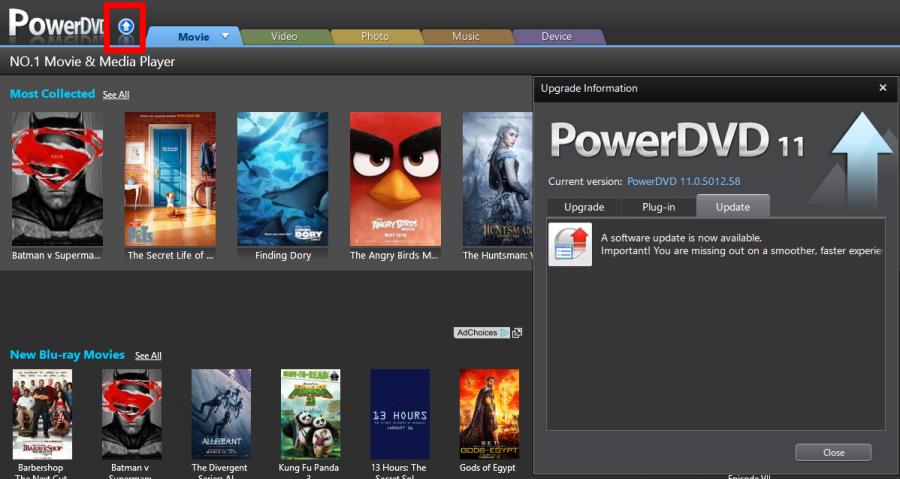

              What version of Power dvd and are their any updates for your version? or plug in's?
