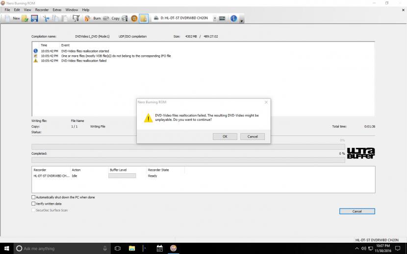

    I downloaded DVDFab about a week ago to try out. I burned a couple of DVDs with no problem so I purchased. A few days after purchasing downloaded and installed the latest version 10.0.1.2, now when I try to burn I get this error message saying DVD-Video Files Reallocation Failed. I am using Nero Burning Rom. Any ideas? Thanks.

      Thanks, I uninstalled then reinstalled version 10.0.1.1 and found I got the same error when burning with Nero. It seems that some dvds will work on full disk and some will not. I dont seem to have this problem when copying just the main movie.

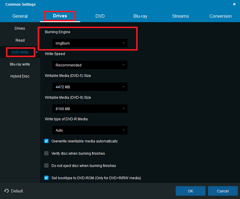

            Thanks for the suggestion, Imgburn worked fine. Now Im trying to set Imgburn and DVDFab to work together. I followed directions of sticky thread but after Fab finished copying to hard drive Imgburn did not open, had to open manually. Ill play around with it awhile, thanks again.
              Set it like so:
                Thanks, I chose Imgburn and have done everything the sticky says but it still wont open until I do it manually. Im just glad Imgburn will burn the DVD so its no big deal. It just would have been nice if it had worked. Thanks again.

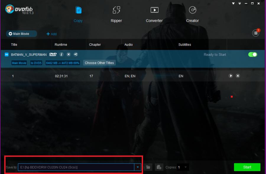

                  Check the "Save To" location and make sure it points to your burner drive:
                    Thanks so much, that was the problem.
