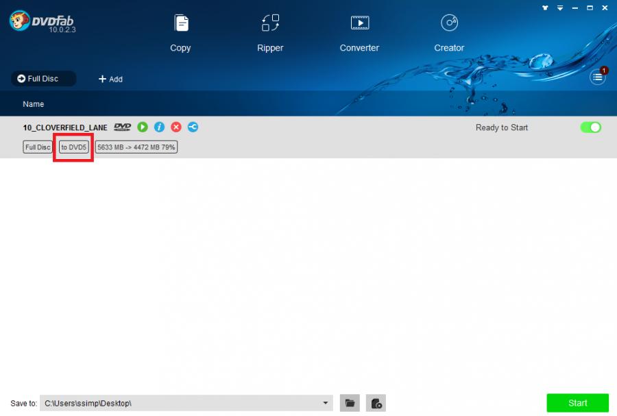

        Now don't get all mad at me, but take a look here and make sure it says "DVD5".
          I use ver 9 to burn to dvd5.
          for some odd instances, ver 10 does not recognize 'to dvd5' burning option.
            After selecting the source click the wrench icon and you'll be able to select the compression and media size. See attached:

                    You have DVD-9 selected as the output if you're trying to burn to DVD-5 media you'll get this message. Cut from your log:
                    2m 01.14s: DVD Copy
                    2m 01.14s: Source: D:/
                    2m 01.14s: SourceSize: 6881 MB
                    2m 01.14s: OutputSize: 8100 MB This line indicates DVD-9 media required.

                        Well all I know for sure is if the output size is 8100 MB is not going to burn to a DVD-5 blank. If you have it set to DVD-5 and the output size is still 8100 MB there is a problem I've never seen.
                              yes, right. The DVD5 4300 should be always shown when set to DVD5 although the result is oversized.
