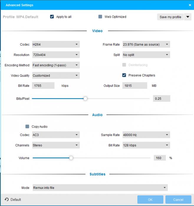

        These are the settings I use for all MP4 files.

          90312 ,
          I tried your settings in a .mp4 & a .mkv as close as possible.
          The .mkv played on my TV but the .mp4 didn't .
          There are a few differences .
          The Audio looks almost the same so I can't figure out why the audio on the .mp4 didn't play. I have had files that only played audio or video . When there wasn't the correct codec for the other.

            I tried an .MP4 with 90312 settings .
            It still didn't work on my TV but did work on my LG BD player.
            I then did an .MP4 as Default ( selected the default button in the lower left of the settings window). It now had the same results .Would not play on my TV but would on my LG BD player.

                    One with settings similar to the one you posted for .MP4.
                    One with AC3 6 channel.
                    Both .MKVs play fine on my TV .
                    I also converted a .MP4 with MPEG-4 with that being the only setting different than what you posted for .MP4.
                    As expected this one doesn't play on my TV.
                    Then an .MKV & .MP4 with h.264 (x264 in MediaInfo) .
                    I used your posted settings .
                    The .MKV plays on my TV the .MP4 doesn't.
