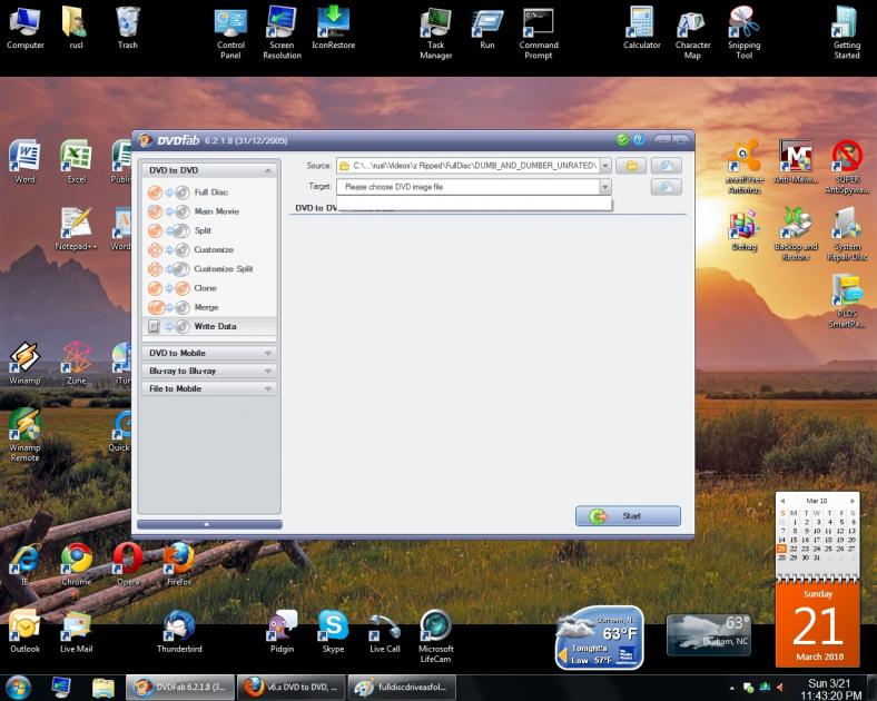

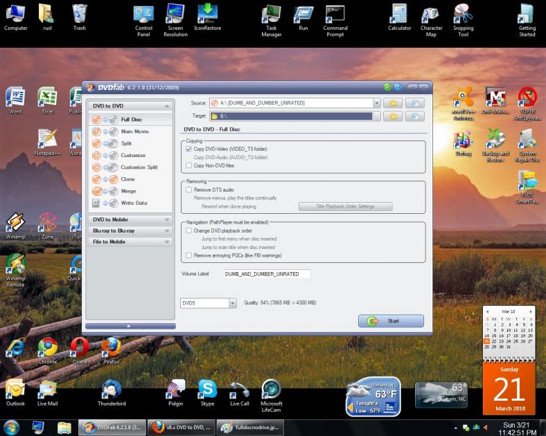

                  Could you post a screenshot?

                    I have the Admin account active, so I also tried logging in under that account and following the admin install instructions to no avail. Here are screen shots. I also included one of my registration screen to show that the program recognizes my regkey and says my features are active and enabled.
