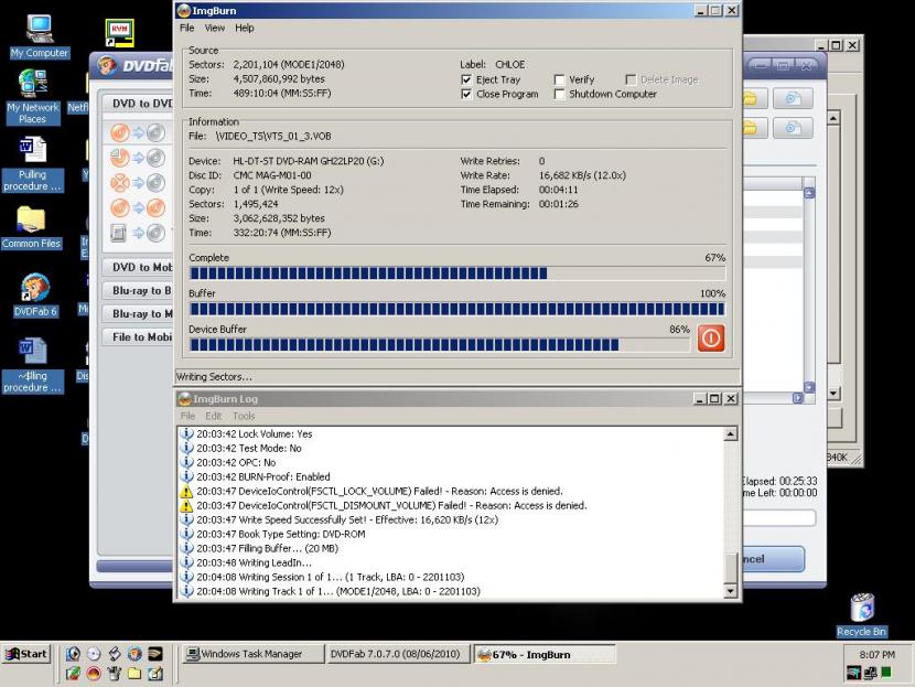

    The process with 7 completed and I got a screen capture of ImgBurn for you.
    The two lines I referenced in the earlier post are still the same as you will see in the attached image. Perhaps I set the AWS incorrectly but I followed the guide here in teh forums when setting it.

      Also the W 18:32:35 DeviceIoControl(FSCTL_LOCK_VOLUME) Failed! - Reason: Access is denied.
      W 18:32:35 DeviceIoControl(FSCTL_DISMOUNT_VOLUME) Failed! - Reason: Access is denied
      is caused by your drive is refusing to over burn, and also something still may be using your drive.

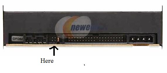

            I read the instructions and I am unclear on " Connect the drive as¡°master¡±by it self, on the secondary IDE controller with no other device on the same IDE cable, making note to set the jumper on the back of the drive to the¡°master¡±position."
            They are refering to the IDE cable's position on the motherbard and not the Drives position on the IDE Cable correct?

                This is what is "stupid" about these instructions, if you only have 1 IDE cable and your drive and hard drive are on it, how are you supposed to do that....Duh how is your computer supposed to run with no hard drive connected these instructions kill me.....
                This is a little jumper on the back of the drive see pic
                No see pic

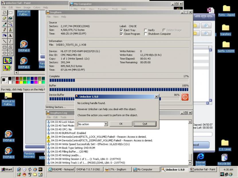

                            Ok, I'm at work right now so I can't post the screen capture I made last night of trying the "unlockIt" software mentioned in the post you referred me to CBR929. I see where you are going and it was a promising lead but unfortunately the second program just flat doesn't seem to work. If it did what it said it would, it would be a wonderful tool for Win2K. Not only for diagnosing my issue but for resolving those times when 2K doesn't want to let go of a removable storage drive. I very well could be trying to use it for something it was not intended for (i.e. drives vs files ) but regardless I'm more than a little leary of the program (wanted to install Bing toolbar among other crap). I will tonight, when I get home, try the first program that post mentioned and see if I have any luck.

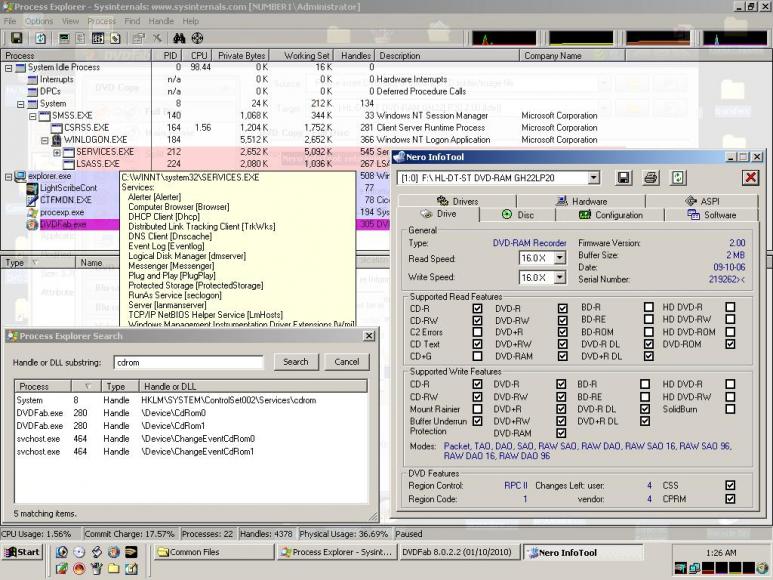

                              Ok here are the picture I couldn't send earlier and a picture with Process Explorer running.
                              Ok I slammed UK! s choice on the second program I should have tried the first... Process Explorer ... I think I wana make sweet lovins all over it.... nuff said. Do you guys see anything out of the ordinary? I had a DVD in Drive F:
