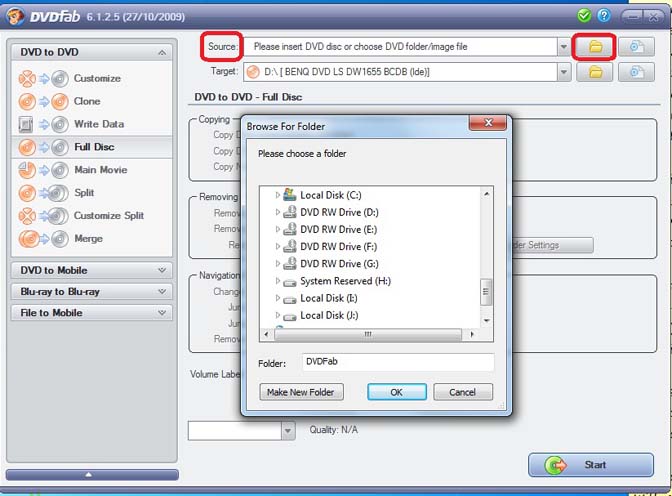

                Does Fab not see the source disc in the dvd-rom drive even when forced?
                By that I mean if you click on the folder icon to the right of Source, from the dropdown, simply navigate to your dvd-rom drive (or anywhere else on your rig).
                If you're able to do this, Fab should "remember" this as source.
                If it doesn't stick, try ticking on Memorize user interface options in Common Settings.
                If still no dice, we'll go from there.

                    Can you provide us with a screenshot?...
                    something like I've attached below?
