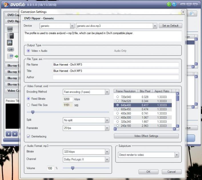

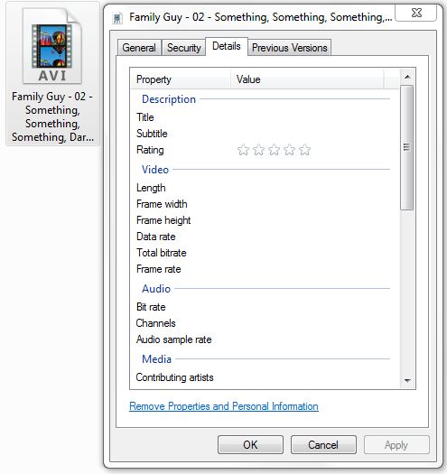

    When converting any dvd using the generic.avi.divx.mp3 or generic.avi.xvid.mp3 profiles the resulting file is missing all tags and properties associated with it.
    The file is also unable to have a thumbnail created.
    I have attached the entry from my log, MediaInfo Text and screenshots showing the conversion settings I used and one of the finished file with missing tags.
    If i use the DivX or XviD audiocopy profiles this issue is not present.
    All A/V Codec Settings are Software
    dvdfab_internal log entry:
    DVDFab 8.0.5.0 (2010/12/02 00:16:44)
    0m 01.95s: option dvd2dvd 1 dvd2mobile 1 bluray2bluray 1 bd2mobile 1 bd23d 1 bd2dvd 1 file2mobile 1 filemover 1
    0m 26.75s: pathplayer enabled
    4m 12.11s:
    ------ begin mobile work(1/1) ------
    4m 12.11s: create config(0)
    4m 12.11s: convert profile(generic.avi.divx.mp3)
    4m 12.11s: dvd title(1) angle(0) chapter(1->12)
    4m 12.11s: stream(480,2,1) stream(128,86019,1) stream(32,94208,4)
    4m 12.12s: subpicture preset(1), mode(0)
    4m 16.34s: subpicture(32) mode(0)
    4m 16.34s: connect to sub render filter
    4m 18.38s: warning: stream tag DX50/0x30355844 incompatible with output codec id '63'
    15m 24.30s:
    ------ finish mobile work ------

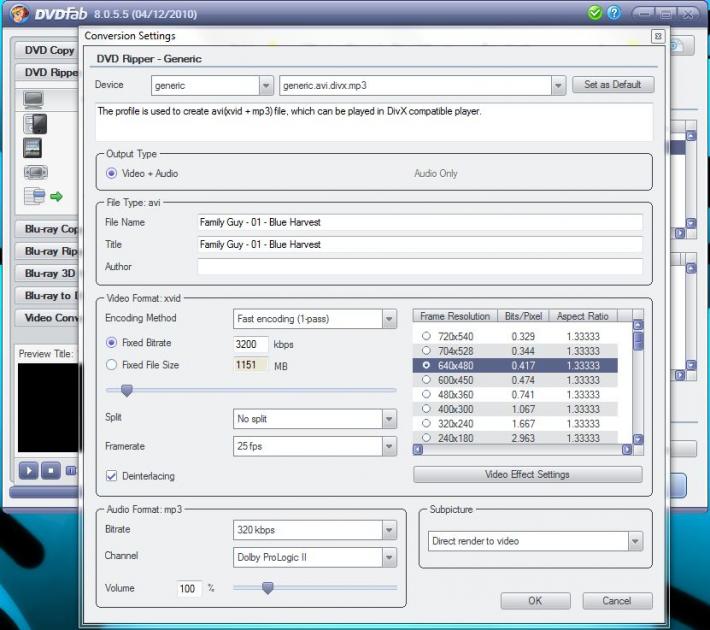

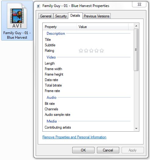

      Hi ting,
      I just tried the new 8.0.5.5 but I'm still getting the same problem.
      Below is the entry from my Log, MediaInfo and screenshots again.
      Log
      DVDFab 8.0.5.5 (2010/12/05 11:40:24)
      0m 02.02s: option dvd2dvd 1 dvd2mobile 1 bluray2bluray 1 bd2mobile 1 bd23d 1 bd2dvd 1 file2mobile 1 filemover 1
      0m 24.27s: pathplayer enabled
      3m 10.92s:
      3m 10.94s: create config(0)
      3m 10.94s: convert profile(generic.avi.divx.mp3)
      3m 10.94s: dvd title(1) angle(0) chapter(1->12)
      3m 10.94s: stream(480,2,1) stream(128,86019,1) stream(32,94208,4)
      3m 10.96s: subpicture preset(1), mode(0)
      3m 15.04s: subpicture(32) mode(0)
      3m 15.04s: connect to sub render filter
      14m 21.87s:

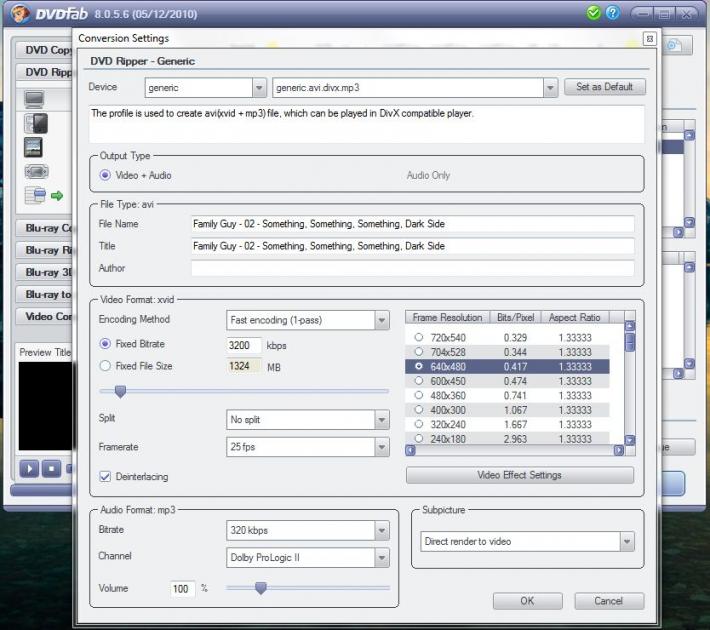

        8.0.5.6 - Missing Tags when using generic DivX/XviD mp3 profile
        Hello again,
        The issue of missing metadata is still happening with the latest release.
        dvdfab_internal log
        DVDFab 8.0.5.6 (2010/12/05 18:51:18)
        0m 01.59s: option dvd2dvd 1 dvd2mobile 1 bluray2bluray 1 bd2mobile 1 bd23d 1 bd2dvd 1 file2mobile 1 filemover 1
        0m 16.59s: pathplayer enabled
        0m 46.64s: pathplayer enabled
        3m 54.29s:
        3m 54.29s: create config(0)
        3m 54.29s: convert profile(generic.avi.divx.mp3)
        3m 54.29s: dvd title(1) angle(0) chapter(1->13)
        3m 54.29s: stream(480,2,1) stream(128,86019,1) stream(32,94208,4)
        3m 54.32s: subpicture preset(1), mode(0)
        3m 58.38s: subpicture(32) mode(0)
        3m 58.38s: connect to sub render filter
        16m 50.84s:
        MediaInfo
        General
        Complete name : C:\Video Encoding\DVDFab\generic\Family Guy - 02 - Something, Something, Something, Dark Side\Family Guy - 02 - Something, Something, Something, Dark Side.avi
        Format : AVI
        Format/Info : Audio Video Interleave
        File size : 832 MiB
        Duration : 52mn 30s
        Overall bit rate : 2 215 Kbps
        Writing application : Lavf52.78.4
        Video
        Format : MPEG-4 Visual
        Format profile : Advanced Simple@L5
        Format settings, BVOP : Yes
        Format settings, QPel : No
        Format settings, GMC : No warppoints
        Format settings, Matrix : Default (H.263)
        Muxing mode : Packed bitstream
        Codec ID : DX50
        Codec ID/Hint : DivX 5
        Duration : 52mn 30s
        Bit rate : 1 882 Kbps
        Width : 640 pixels
        Height : 480 pixels
        Display aspect ratio : 4:3
        Frame rate : 25.000 fps
        Color space : YUV
        Chroma subsampling : 4:2:0
        Bit depth : 8 bits
        Scan type : Progressive
        Compression mode : Lossy
        Bits/(Pixel*Frame) : 0.245
        Stream size : 707 MiB (85%)
        Writing library : XviD 1.2.1 (UTC 2008-12-04)
        Audio
        Format : MPEG Audio
        Format version : Version 1
        Format profile : Layer 3
        Mode : Joint stereo
        Codec ID : 55
        Codec ID/Hint : MP3
        Duration : 52mn 29s
        Bit rate mode : Constant
        Bit rate : 320 Kbps
        Channel(s) : 2 channels
        Sampling rate : 48.0 KHz
        Stream size : 120 MiB (14%)
        Alignment : Aligned on interleaves
        Interleave, duration : 24 ms (0.60 video frame)
        Interleave, preload duration : 24 ms
        Writing library : LAME3.98.4
        Attached are screenshots showing conversion settings and file with its missing metadata and thumbnail.
