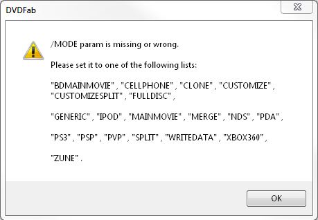

    I am running version 6.2.0.5. When I run the command line specifying the mode to be "XBOX360" and try to specify a profile of xbox360.wmv.wma9 or anything like this, it tells me it needs to a zune profile. Also, once it opens the app, it is in the zune section, NOT the XBOX 360 section.

          Thank you SOO much! *This* is actually VERY helpful, but it kind of upsets me since this same information is NOT available via the installed product. Using the ".\[path]\DVDFab.exe /?" only provides a VERY basic listing of options, and the readme.txt that is included with the install does NOT list the correct mode switches (apparently... at least according to the post you directed me to). The readme.txt only lists "XBOX360" as a mode, which I pointed out actually launches the "DVD to Mobile" Zune mode, NOT the XBOX 360 mode. The post you directed me to lists "DVDXBOX360" for the "DVD to Mobile" mode switch... but I just tried to run that with version 6.2.0.5 (11/11/2009) and it throws an error that "/MODE param is missing or wrong", and then proceeds to list what the valid modes are, "DVDXBOX360" not being one of them and "XBOX360" being valid.
          However, if I run the "XBOX360" mode switch parameter, like I said, the Zune mode is actually what's run and it throws an error that the profile param is incorrect and suggests Zune mode based profiles... which brings me right back to my original post.
          So, the command line interface for "DVD to Mobile" using the XBOX 360 mode is broken, or the parameters are not correct.
          I'm going to try and attach the screen capture of the error.
          Please let me know what else you would like me to include, if anything.
