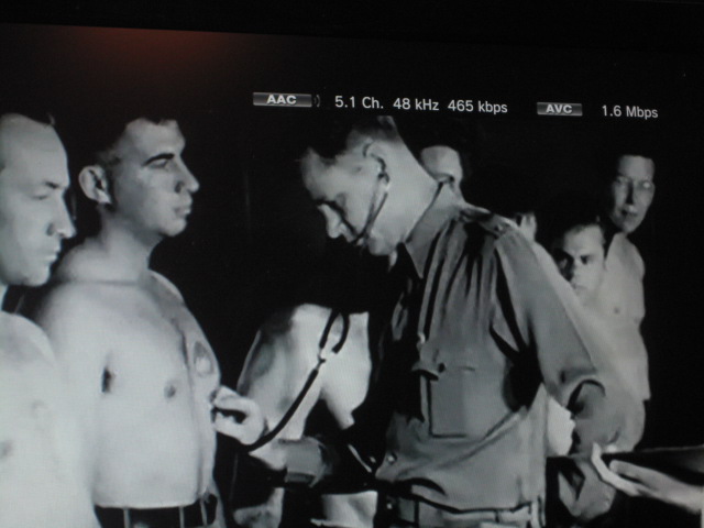

    If you must use 5.1 do not exceed 256 kbps, I just finished Captain America using 5.1 @ 256 kbps and it's perfect (so far).

        I don't need it mostly, don't have any more than the stereo speakers on the TV. I usually downmix to stereo, but if you need 5.1 it does work on the PS3, at least on mine. I don't stream to it, gave that trick bag up long ago, I put a $50 500GB HDD in it and shuttle the movies over on a thumb drive. I have the FAT32 limitation but the grandkids don't seem to mind.

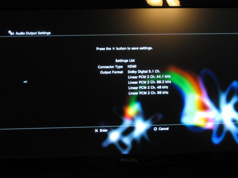

            Do you guys have the PS3 connected via HDMI cable? If so I can walk you through setting the PS3 for 5.1, if not you are on your own. In any case I think you are going to have to look somewhere else because DVDFab works fine.
              I do have it connected with the HDMI and it is setup to play AAC. If I run it through with DIVX AUDIO copy everything works fine on the PS3. I wanted to switch to the PS3 profile to save space on my NAS. So its something in the profile not the PS3. I am going to downgrade two versions to where the profile worked before and see if the profile works again.
                Suit yourself, but as you can see from the snap of the PS3 screen it can and does play 5.1 made with DVDFab 8.1.3.2

                  I need to correct a mistake I made, when the PS3 is properly setup it will indeed play a file created with the PS3 profile using 5.1 @ 448 kbps version 8.1.3.2. Sorry for the misinformation.
                    What PS3 config is that? "PS3 is properly setup"

                        Go to settings and down near the bottom is audio output settings, select HDMI then automaic and check the next page it should look like the snap in post #8. If the sound comes out equal from all speakers I wouldn't know like I said I only have stereo.
                          @90312 You are wise - the answer is in your message HDMI!
                          I had to switch to a HDMI input and change to bitstream in my PS3 Audio setup.
