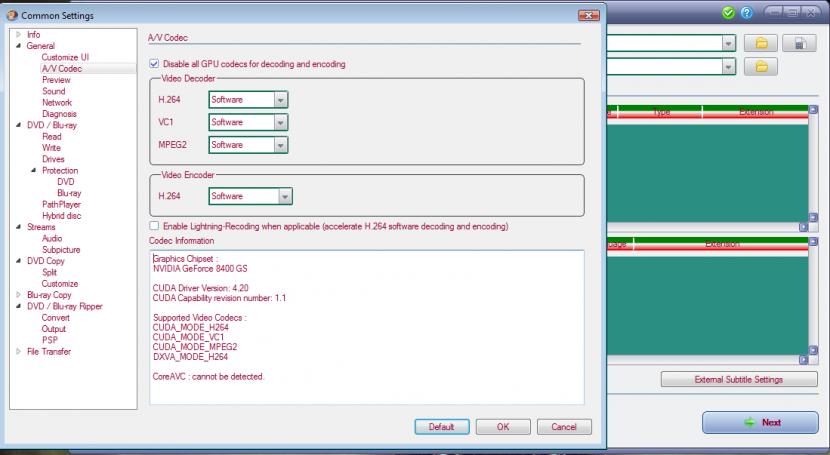

            Hi NSViper
            Please disable Cuda and try again, see my pic for settings.
            Open Fab click the Click the Green at top right corner of the DVD Fab screen, and open Common Settings > General >A/V Codec, put a check in Disable all GPU codes and make sure they are set to Software, restart Fab.
            Hope this helps

              I've tried multiple combinations of settings:
              Software only
              CUDA only
              Software + CUDA
              But will try again and let you know how I get on.
                Ok tried that again.
                Also tried combinations of single and dual pass, both direct from bluray, and also used bluray copy to copy entire disk to local hdd 1st of all.
                Still same error codes on both blurays.
