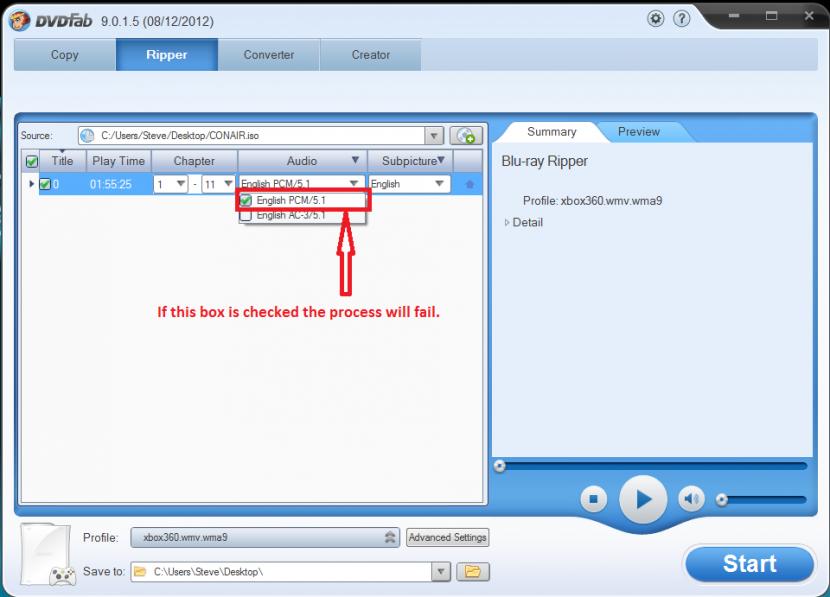

      I have been struggling with BD rips with both 8.2.x and 9.x... My process has been to BD FULL cpy selecting remove BD Audio once that is done I rip it to MKV. In my last case of Spiderman 3 (not to be confused with The Amazing Spiderman)... My rip would fail error 500.01.2. I was able to over come this by selecting the audio format AC3 5.1 as opposed to the the PCM DTS which DVDFAB wants to use. Maybe this will help you.

          I can reproduce the failure, I tried different ways best result was from an iso image on the HDD but ultimately failed.

            I found my problem and maybe yours? I know that you can't use PCM audio so I selected ac3 5.1. I assumed wrongly that the PCM stream would be deselected but not so and the process failed every time. I tried again and double checked the audio stream in the source and sure enough both streams were checked after selecting 5.1. I made sure the PCM stream was unchecked and the process completed successfully.

                No dice. Still error'd out. Have En DTS-HD Master/5.1 as my audio
                  Is that your only option for audio?
                    On that disc yes. At least that's the way I remember it. I'll double check when I get home and update. If it is, I"ll grab a different disc and try it. I have a massive stack of DVD's and BluRay's I need to get ripped.
                      I have options
                      English DTS-HD Master/5.1
                      French AC3/5.1
                      Spanish AC3/5.1
                      Support did finally contact me and told me to run it with all GPU disabled.
                        Yeah and I guess I forgot to mention I had to turn off lighting recoding too.
