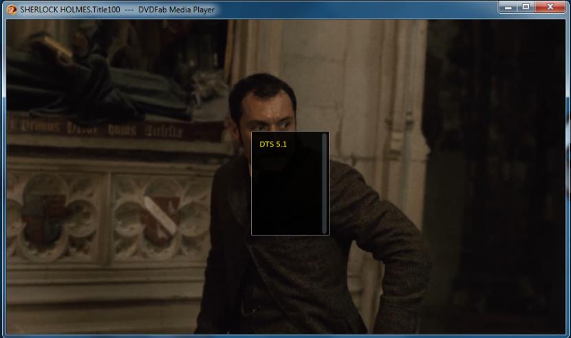

      I checked mkv.h264.audiocopy to make sure the software works v 9.0.2.0 and it works ok here. I can't reproduce the issue. MediaInfo and screen shot attached:
      Complete name : E:\SHERLOCK HOLMES.Title100.mkv
      Format : Matroska
      Format version : Version 2
      File size : 5.79 GiB
      Duration : 2h 8mn
      Overall bit rate : 6 460 Kbps
      Movie name : SHERLOCK HOLMES.Title100.BlurayRip
      Encoded date : UTC 2013-01-13 02:59:10
      Writing application : DVDFab
      Writing library : libebml v0.7.8 + libmatroska v0.8.1
      Video
      Format : AVC
      Format/Info : Advanced Video Codec
      Format profile : High@L4.1
      Format settings, CABAC : Yes
      Format settings, ReFrames : 2 frames
      Codec ID : V_MPEG4/ISO/AVC
      Duration : 2h 8mn
      Bit rate : 4 822 Kbps
      Width : 1 920 pixels
      Height : 1 080 pixels
      Display aspect ratio : 16:9
      Frame rate mode : Constant
      Frame rate : 23.976 fps
      Color space : YUV
      Chroma subsampling : 4:2:0
      Bit depth : 8 bits
      Scan type : Progressive
      Bits/(Pixel*Frame) : 0.097
      Stream size : 4.32 GiB (75%)
      Writing library : x264 core
      Default : Yes
      Forced : No
      Color primaries : BT.709
      Transfer characteristics : BT.709
      Matrix coefficients : BT.709
      Audio
      Format : DTS
      Format/Info : Digital Theater Systems
      Mode : 16
      Format settings, Endianness : Big
      Codec ID : A_DTS
      Duration : 2h 8mn
      Bit rate mode : Constant
      Bit rate : 1 509 Kbps
      Channel(s) : 6 channels
      Channel positions : Front: L C R, Side: L R, LFE
      Sampling rate : 48.0 KHz
      Bit depth : 24 bits
      Compression mode : Lossy
      Stream size : 1.35 GiB (23%)
      Default : Yes
      Forced : No
