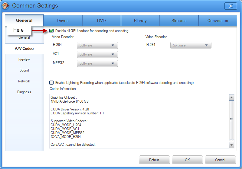

Is it the same if you disable Cuda?
If not then it is Cuda.

I'll give it a try tomorrow to see. If that is the problem the that means there's an issue with the CUDA coding in the program right? I mentioned this because I tried it on another ripping program that also uses CUDA and the audio was in synch, there was just another issue that made me come back to dvdfab for this rip.Last edited by dglidden; 02-24-2013, 03:50 AM.
