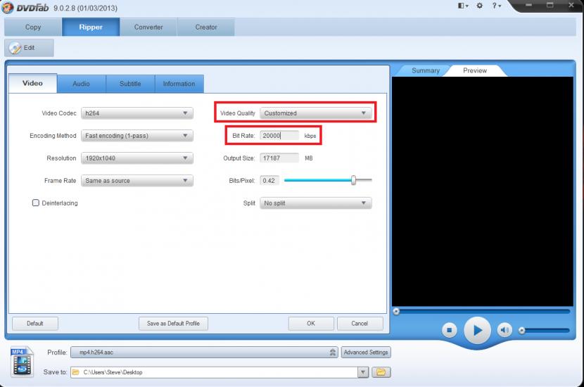

    Larry, I've tested this a few times today and it has worked pretty good. I set the bit rate to 20,000 and it comes out 19,400 or so. Are you setting like in the snap below:
      Thanks for the reply.
      The only difference I can see is that I'm using 2-pass, which you used 1-pass. This could be the difference.
      I'll do some tests to see if using 1-pass results in correct bitrates for me, but that wouldn't solve the issue because 2-pass produces superior results.
      In the mean time, do you happen to know if your result is using the Main profile instead of the High profile? As I mentioned above, 9028 is using the main profile, whereas 8228 used the high profile (higher quality) in the same situation.
      Thanks,
      Larry
