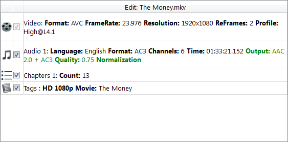

        The output profile for ATV should look similar to this.
        See attached.

                    There are two audio tracks in the output files. The first is ac3 5.1 and the second is aac 2.0.
                    AppleTV will set the ac3 5.1 as default. If you do not use amplifier,you can change to the aac 2.0 audio by clicking the round button in the remote control for a while.
                    iPad will use the aac 2.0 audio as default.
                    If you connect your AppleTV to TV directly, do remember changing the audio track to aac 2.0.
                      Terry.

                        I know it. I have tested the output file in iTunes,iPad,AppleTV. All are OK. So please wait for the next release and try it. Thanks.
