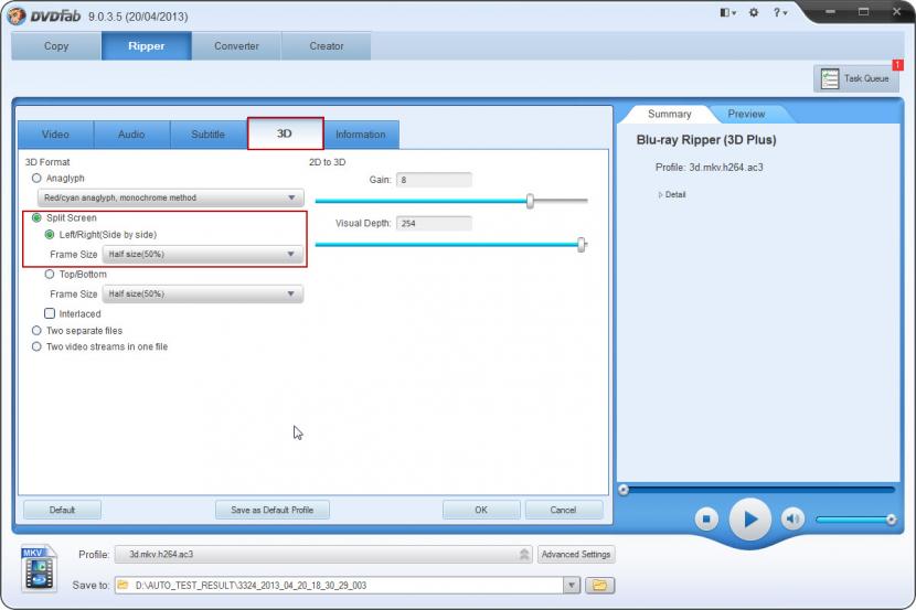

    I have heard it referred to as "checkerboard." I can not determine how to rip my 3d's to that format. I always get top/bottom. Any help would be appreciated. I have an Optoma hd33 dlp projector
    I suppose that the SBS format is OK for your Optoma hd33 dlp projector.
    See the attached screenshot.
      Checkerboard is the way a projector displays 3d and has nothing to do with the way you make 3d movies with Fab.
      The projector supports all HDMI 1.4a mandatory 3D formats,Please refer to your projectors manual or go to the Projectors web sight.
        Thankyou, but isn't that side by side? That does not work for me

          Here's how to make a 3d side by side from a 3d movie with Fab version 9

          To use Fab to make any size side by side 3d disk
          Use blu ray copy to make a iso copy from store brought disk to hard drive.Then open blu ray ripper
          load iso movie in ripper
          click profile box (lower left corner)
          click 3d format (upper bars)
          click m2ts (left side)
          Were going to double click the (3d m2ts audio copy normal profile) last profile on right.
          Now click on advanced settings
          under video (top bar)
          Under video quality make your choice, high quality for bigger more detailed file's, normal file for medium size file's and small for the same.You can also fool around with custom size and adjust the bit rate and file size yourself.
          If you choice hi quility the file may be big enough that you have to burn it on a blu ray disk.Normal may fit a 2 layer db9 regular dvd and small may fit a regular dvd db5.
          Now click on 3d (top bar) left side both split screen and left & right side by side should be checked the circle should be green.
          click ok
          click start and your good to go.Their are other ways and choices to make to do this but this should give you a good starting point.
          If you look at the preview the movie should be playing frame by frame and you should see 2 pictures side by side playing in the preview box this is correct and will play in 3d when your done.The TV or projector must then be put in 3d mode side by side to view this file or disk in 3d.
