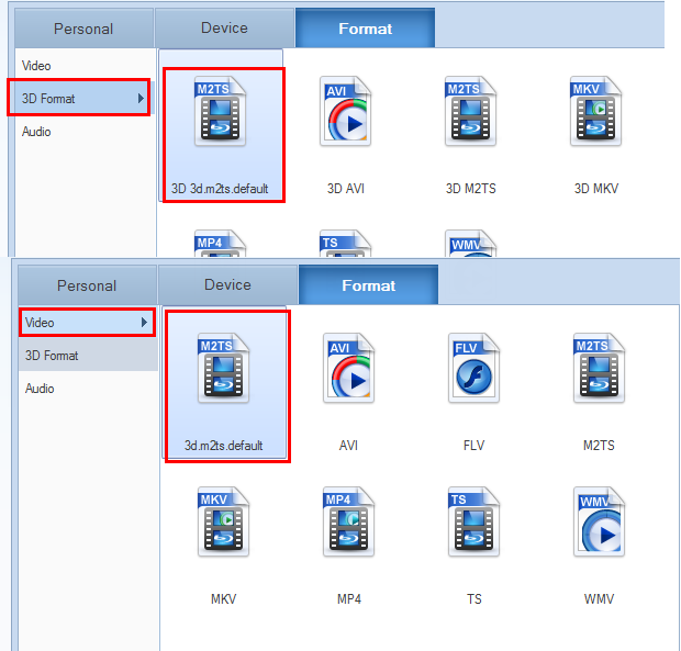

      Did you install DVDFab with the overwrite installation? And the profile "3d.m2ts.default" is translated to one 2d profile and one 3d profile in V9065.
      I suppose that you are selected the 2d profile in Videos table, not the 3d profile in 3D format table.

        glenns ,Advanced Settings page allows you to select the audio and video codecs, and the Video, Audio, Subtitle and other content onto one page, so you can quickly find what you need to edit option.

            I guess even though I had Fab save my settings when i re installed Fab that fab did not keep my settings for keep aspect ratio the same as source.
            Their is one other thing you can't change title name this disk has all numbers for name I want to put in the title name the name of the movie.
            Can someone explain the CRF what it does and when to use it.At what settings to set it at as most don't know what this does or how or when to use it?
              Edit title name
              [/QUOTE]
              We will support changes to the title name as soon as possible.
                I've also noticed the SBS issue yesterday, It should be fixed in V9066. Please have a try.
                You can get the introduction of CRF in the website.
                  Thanks Wilson my first 3d side by side using cuda and CRF came out looking great this is really going to improve Fab output files.
