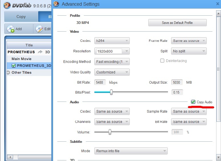

      Hi, madeinlisboa
      If you need to retain the DTS soundtrack, you need in the Advanced Settings, select "Copy Audio" at least.
      You can choose 3D MP4 or 3D MKV Profile.
