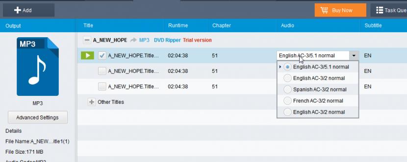

        For some reason, DVDFab select two audio tracks when converting, It should be select only one when ripper to mp3.
        Please select only one audio and try again.
          Not sure where to make that selection
          Thanks for the feedback (I appreciate it).
          Can you tell me where in the UI I could make a selection (tell the ripper to only select one of the two tracks)?
          I poked around but couldn't find a way to do it.
          Thanks in advance.
            Workaround
            First off, Wilson thanks for helping me with this. I really appreciate it. I would never have figured out that was the issue from the log.
            The UI only allows you to select one track for ripping so I'm not sure why this kept happening. To get around the issue, i ripped the DVD to disk as an ISO and when I did this I made sure to only select one audio track. Then I converted the ISO to MP3. Since there was only one audio on the ISO there was no reason for the ripper to get confused and it worked. I was able to rip to MP3.
