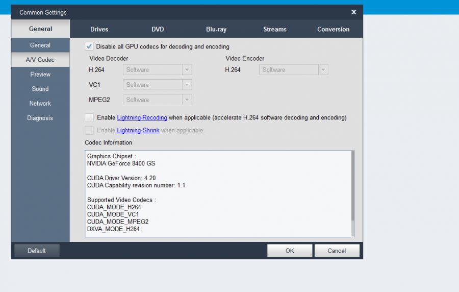

    Hi flow79
    Please try turning off Cuda and use software settings, see pic
    If still having problems post the entire internal log for this movie.
    CBR929
      Your suggestion worked! Thanks!
