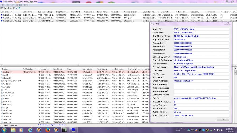

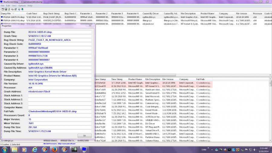

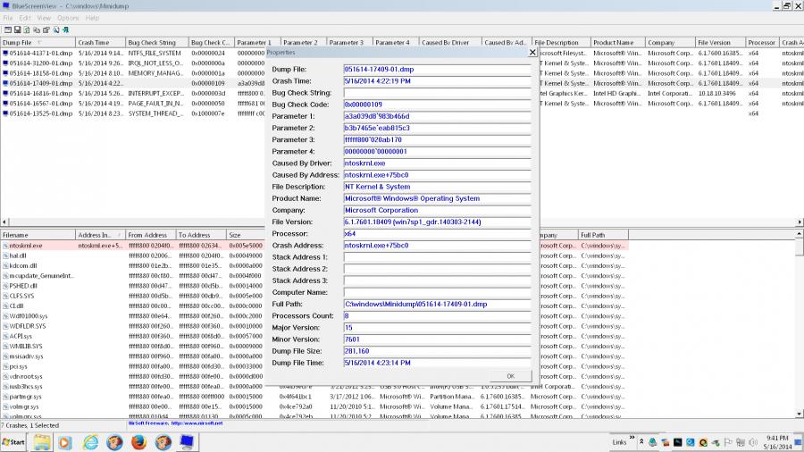

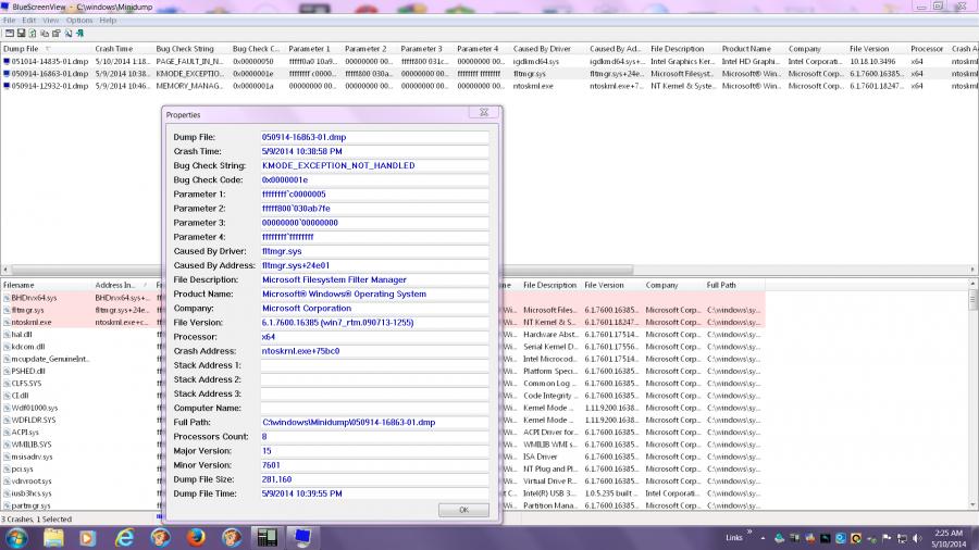

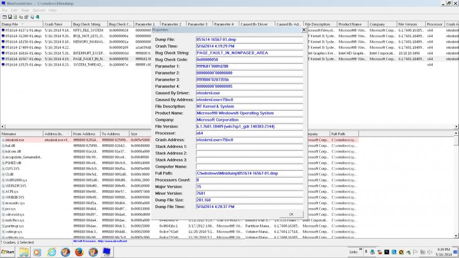

        I have been getting mini blu screen dumps for weeks now sometimes when doing nothing at all. The blu screen debugger program lists different things wrong all the time with different drivers.
        I did a memory and hard drive check with windows and everything is fine.I reverted back to Intel 4000 older drivers that came with the computer with no luck.
        I did a deep scan and full scans for any viruses with 3 different brands of software no luck.The computer is I-7 using windows 7 home only 5 months old so i am at a loss what to do as I still get blu screen dumps daily sometimes 3 times a day and they happen in Safe mode also.

          After running memtest86 5.01 a free memory test that takes hours to run both my memory ddr3 sims are going bad and this accounts for all my blu screen mini dumps and my Fab error 45 protection errors download i reported in another topic.
          This is the reason why the program didn't run.Funny other versions of fab did run though.The memory test that windows does didn't find anything wrong with my memory so that test is crap.Just in case anyone has this problem they should know windows own memory test is not a good way to test for bad memory.
