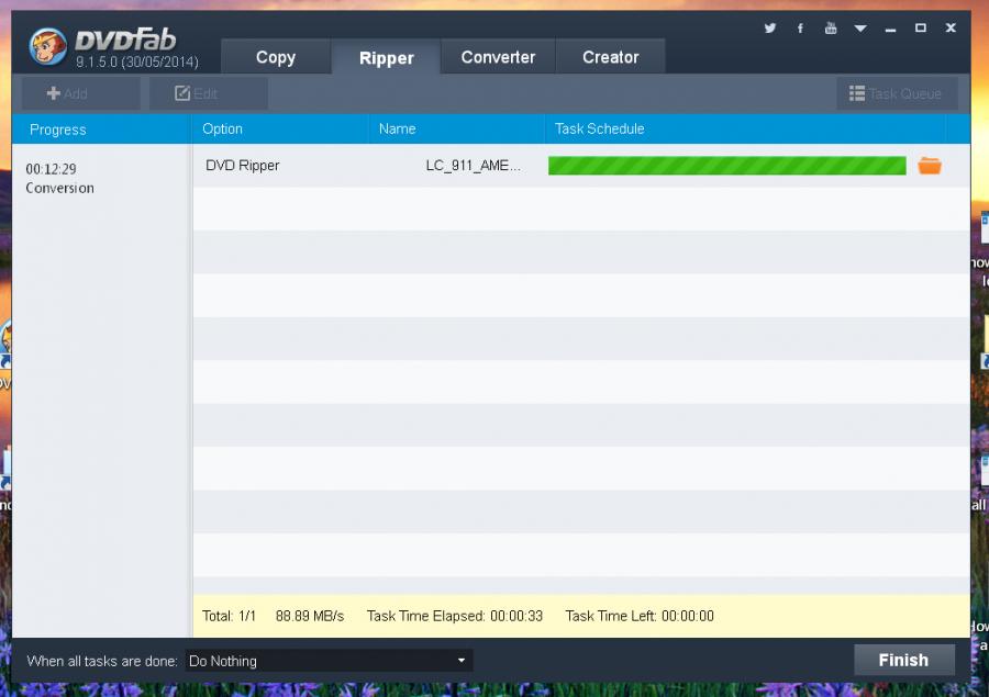

    i7 3770 using IQS making mkv files for my media player. On BR to mkv I get around 200fps on DVD to mkv I get around 1000 more or less. Attachment for credibility:
      I7-3770 using IQC 1hr 38 min dvd movie to MKV I clocked in at process done 33 seconds 88.89 mb/s.
      90312:Why is Fab reporting your frame rate in FPS and mine reporting in MB/S? Whats my frame rate? I thought our specs were the same except I went for the faster memory.

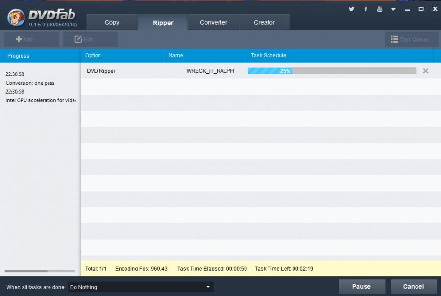

        My first test was dvd to mkv but I used passthrough and that profile won't use IQS as it didn't have to compress so I did a second test with MKV with the Fab defaults for MKV profile and that test came in at 2mins 32 seconds for the same movie as the first test that only took 33 seconds and seemed really fast.
        This time Fab reported 932 FPS with the FPS going up and down as per the encoding demands but staying in the 920-970 range for this movie.Using other settings other than the Fab default in a given profile will give different results.

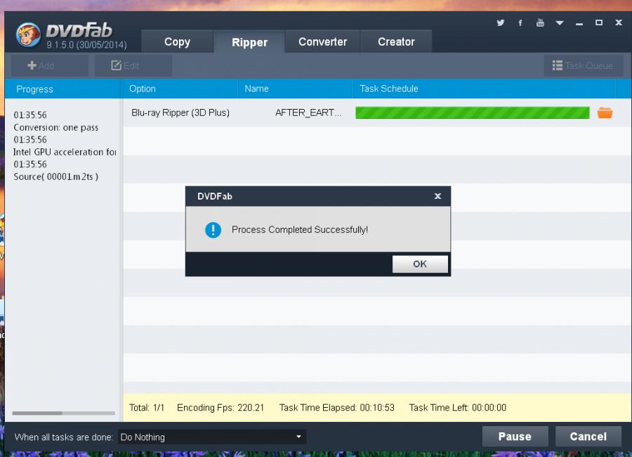

        For blu rays I converted the movie Afterearth using the MKV profile with default settings FPS came in at a range of 210-222 FPS and 10 mins 53 sec job time.
