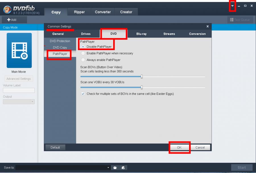

    Assuming the disk is clean and not scratched up you can try turning pathplayer off in Fab settings turn back on when done then check content to see if the whole movie is their.If that don't work try version 8 of Fab.

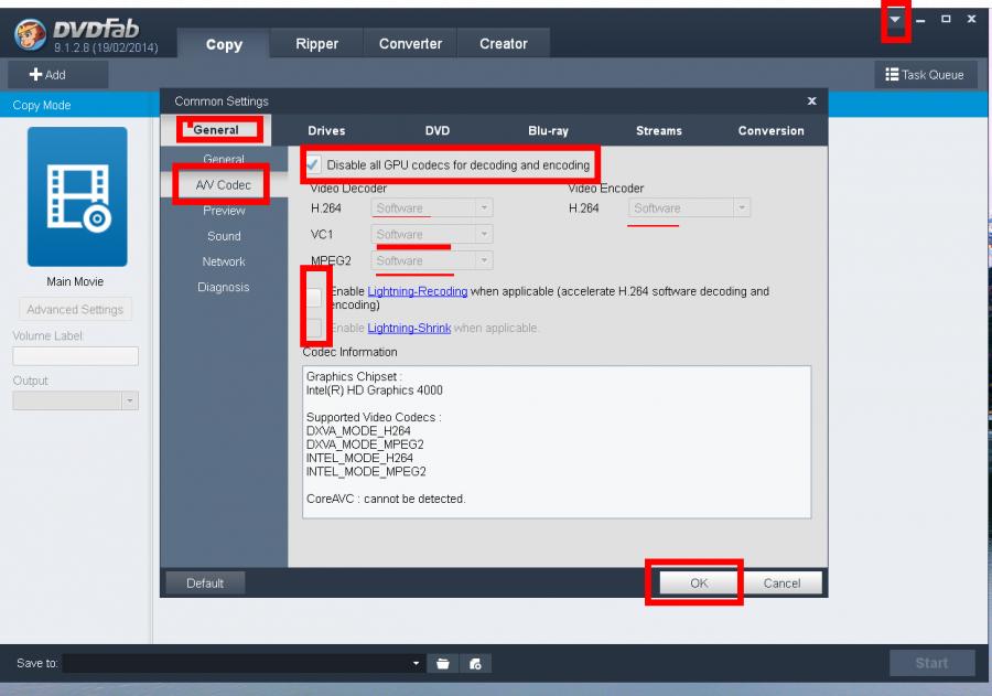

    NVIDIA GeForce GTX 260 : 5.50 : 1.3 this card is not on list but still uses new cuda drivers so they may not work with fab so if above doesn't work roll back the cuda driver to to the old driver version 334.89 or 335.23.You can also set use all software for the conversion but it will be much slower.let us know how you make out thanks.

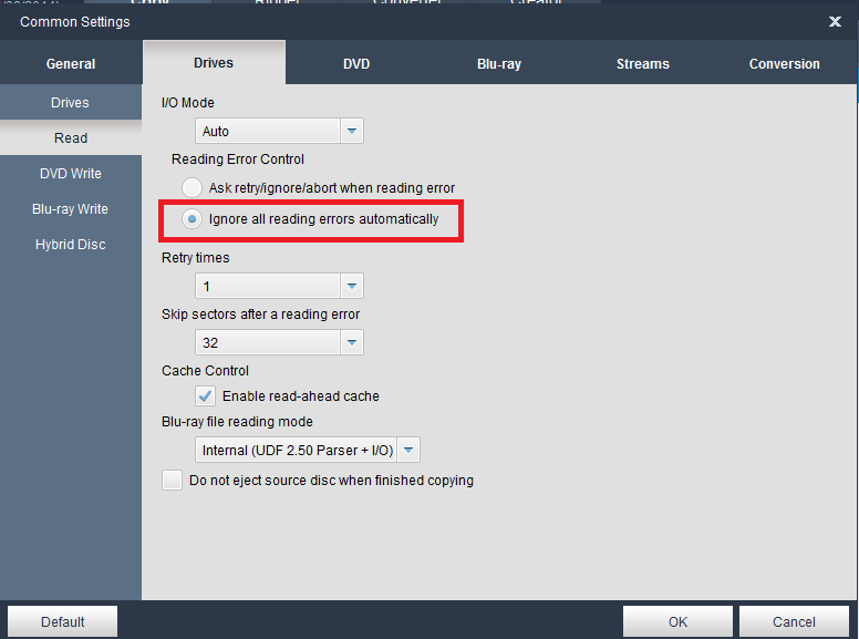

                  You might also try going into common settings here and tick this, it might ignore the read error and skip that part.
