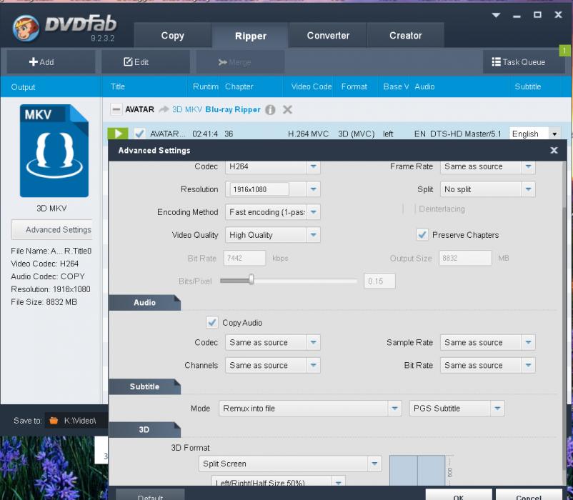

    I use the 3d mkv profile for side by sides see screen shot for my settings.

    To save a lot of space reduce to side by side 50% hi quility i make mine mkv's and keep the hd soundtrack discarding the hd sound saves space so decide whats more important to you hd sound or not then remember when making side by side 3d you cut resolution in half they still can look good but its no longer a blu ray.They are hi def.data disks but not full resolution.The 3d efects both depth and pop off screen effects still remain and on smaller screens you may not tell the difference but 50 inch on up you can tell the difference.Their even good on my 150 inch 3d front projection screen made in hi quility but remember their half resolution in one eye 1080 in the other and letterboxed movies even less resolution.You need to judge on your own system if compared side by side with a blu ray the blu ray wins hands down but The side by side is very watchable and saves major space on the hard drive or disk.Also side by sides can be reduced to fit on regular dvds 2 layer or even 1 layer disks.I would recommend only 2 layer disks or better yet on a UBS harddrive for storage.Make some each way and compare them on your equiptment then decide.
