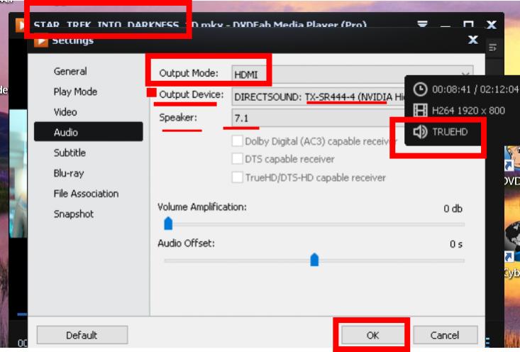

                      NIK:Adjust Fab media player when receiver is on as Fab looses setting for hdmi when receiver is off (maybe by design),Set as you see in my screen shot then try again please.
                      Wilson:Can you or other staff check why this happens when receiver is off Fab media player will change from HDMI set in settings to something else (in my case to tiger jet internet phone Magic jack)but once receiver is turned back on the settings go back to HDMI.
