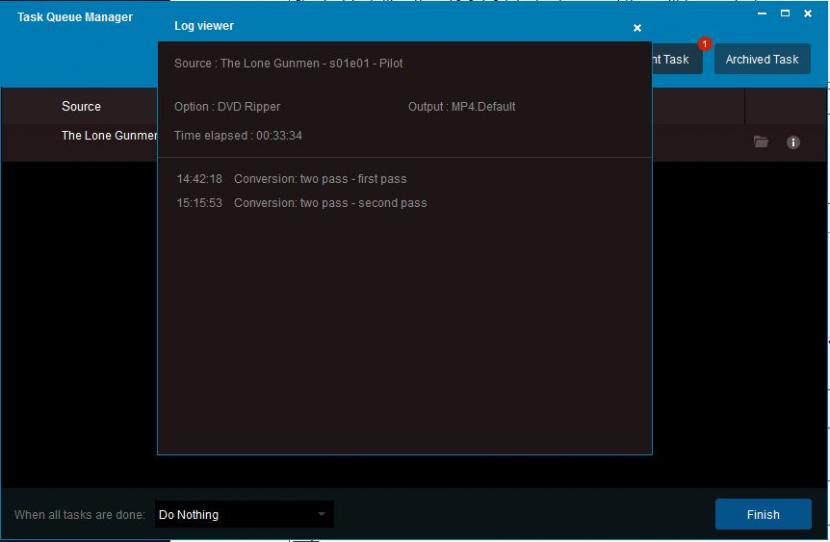

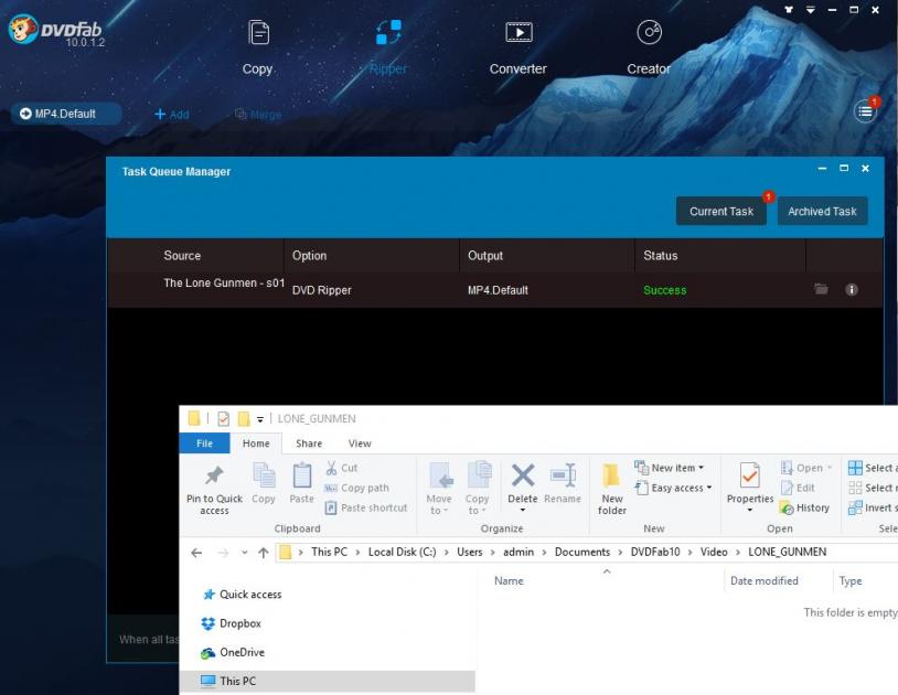

I have a similar outcome although I don't seem to have the same error. Full Internal log attached. Trying to rip down a series DVD(The Lone Gunmen) to watch on my commute.
Version 10 seems to run through successfully to completion without issue and I don't see anything odd along the way. But the created folder is just empty when it finishes.
I'm trying v10 as 9.3.2.1 now simple fails to copy a series disk. V9 fails after 50% for each episode. However happy to move forward with V10.0.1.1, it looks better.
ASk if more info is needed.

I upgraded to 10.0.1.2 and ran a rip in single pass mode.
It finished after a few seconds and ejected the disc. Nothing was created.
I have gone back to two-pass which is running but I expect the same "empty" behaviour.
Log attached.Attached Files

Still same behaviour
I recorded the first "inspector Morse" episode (2 on each disc) and it was fine. I did notice that a file was there at the start of the second pass with Morse but not with "Lone Gunman" so perhaps that is the issue not the second pass.
Retried a "Lone Gunman" episode (5 on disc) to see if it is the number of series on each disc. Same no file generated issue even with "default" settings.
I have checked the drivers (Asus which I'm using) is out the packaging yesterday and windows says both are fine. I will pull the drivers and firmware from manufacturers website, but it is just reading at the moment. I swapped out the drive with a new ASUS model in case the drive itself was at fault.
Since it records some I'm more inclined to think it is fault in the software or the disks them selves. Plus recordings fail in both drives in the same manner. I have attached the accumulative log.
Trying a "Eureka" disc now as it has 5 episodes on a disc... to see if i get the same behaviour, even though I'm only recording the first from it. Using default screen size at this point again.Attached FilesLast edited by ToxicStar; 11-29-2016, 08:40 PM.
