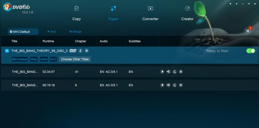

          The columns may be so wide that they push the symbol off the right side. Grab the right side of the column and pull it to the left just until the symbols show up.

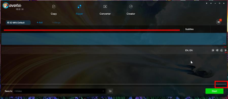

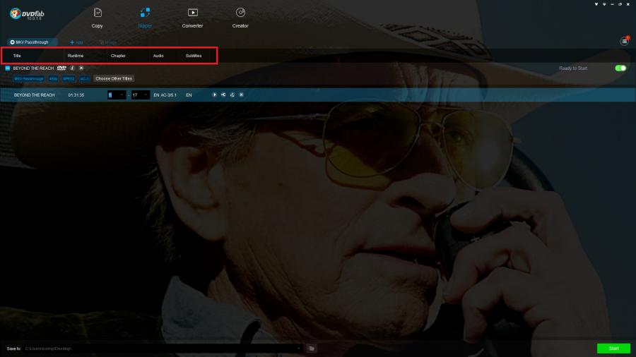

                    As I said columns can be moved left and right but they stop at a point I marked in another topic in a screen shot the columns can't be moved up and down just right or left and the info. in that bar resolution/video type etc. are all spread out.using the windows bar to move the information in that bar doesn't bring up the missing buttons nor does moving the columns left or right because they stop moving at the first button that's the play button for viewer the other 3 buttons are off screen.This only happens in ripper copy has the buttons in different places and version 9 and all other programs work fine at 1920x1080 resolution 150%.You can also add info. to that bar by left clicking the mouse you can add 4 other things to it like type of video/resolution etc. even if unchecked to make more room for the others it still acts the same and returning to the native 1920x1080 resolution at 100% doesn't help nor a clean install.
                      After doing extensive testing and signing off windows between each change from 100%-125%-150% scaling version 10 will run correct in 100% only any attempt to resize the scaling to 125% 0r larger will run the advanced settings off screen with the other buttons except for the video preview button and no amount of setting the columns right or left won't bring them back.
                      Cure for now till this gets fixed is to scale to 100% for those that use 1920x1080 resolution windows 10 fab version 10.Effected only in ripper copy is ok.If set this way then you must log off windows and log back on then it works and if the buttons are off screen they can be pulled back on screen only at 100% any larger it won't work to get all 4 buttons back on screen.These buttons control advanced settings,video viewer and the other two buttons next to them.Hope this helps those effected.I understand viewing everything at 100% is tiny on at 1920x1080 but till it's fixed do this or use version 9 if you can.

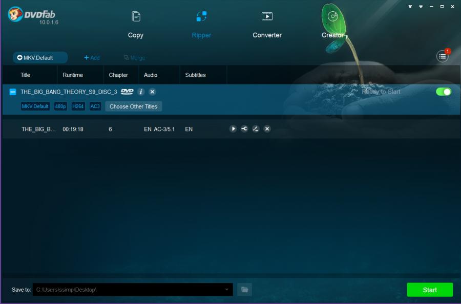

                        Mine works at all percentages. If the symbols go away select a different profile and then switch back, should come back. Attachments:

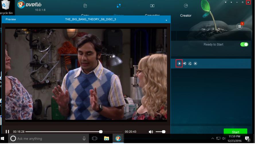

                          Also when it worked once the x button was 1/2 off the screen but it could be used.Now if you look at your own screen shots one also had the x on the top right of the page 1/2 cut off.Also your screen shots are not showing the 4 other items that can also be added to that same line by left clicking the mouse I need these when working with 3d files they are video codex/resolution/aspect ratio and format but even with these unchecked results are the same scaling work still needs to be done on version 10 to get it to work correctly above the 100 percent settings.

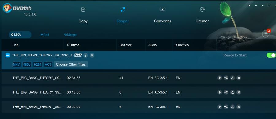

                            This is @ 175% but I'm sure there is still more you need. Show me what you need and can't get.
                              At 1930x1080 150% screen shot one shows when it works once by changing the profile to another profile other than my saved profile but this only will work once sometimes. Closing fab and reopening it then it goes back to missing buttons (3),Notice in screenshot 1 the titles in the bar are spread out far it would take 3 screenshots to show everything notice the windows bar is all the way to the right side and the buttons are their but the x is cut off a little the last button.

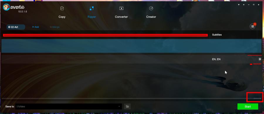

                              Screen shot 2 shows when it doesn't work the title bar still has 3 screen shots of spread out information and the windows bar is all the way to the right.No amount of scrolling the title bar left or right will bring back the missing buttons.when you try that sometimes the remaining play button for viewer disappears.
